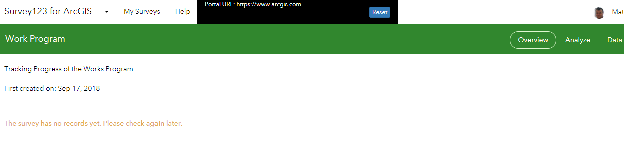

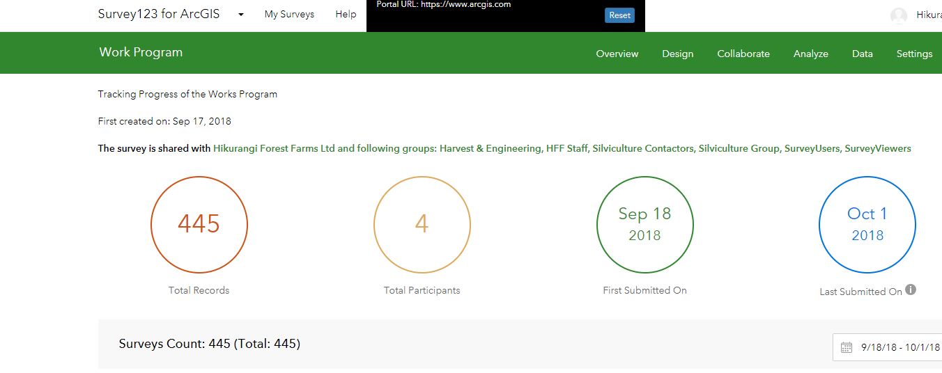

I have one survey that if logged in as the creator (take that anyway you like) I can see Creators view of the Website Admin Page
But when you sign in as any other contributor or anyone whom has access all they see is this

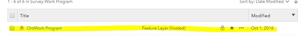

The only thing that I can think of is the this is not the first time that I created "Work Program" Survey and somehow Survey123 has got stuck and picking up an old copy of one without any data in it.

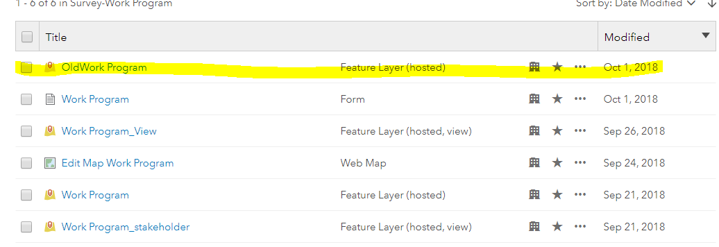

I do see a feature layer (hosted) that has no data in it but I am hesitant to delete it in case it breaks the rest of the system
I have renamed it to "OldWork Program" which made no difference.as per

Survey123 controls access for data viewers through a feature service view called surveyname_stakeholder. In this case it is called Work Program_stakeholder. Sometimes these views get out of sync with the underlying feature service (especially when editing permissions in AGOL), so try deleting and re-creating the view.
To do this, delete the Work Program_stakeholder item in ArcGIS online.  Then reshare the survey to the viewers in survey123.arcgis.com=>collaborate. The Survey123 website is the place for updating sharing permissions for surveys.
