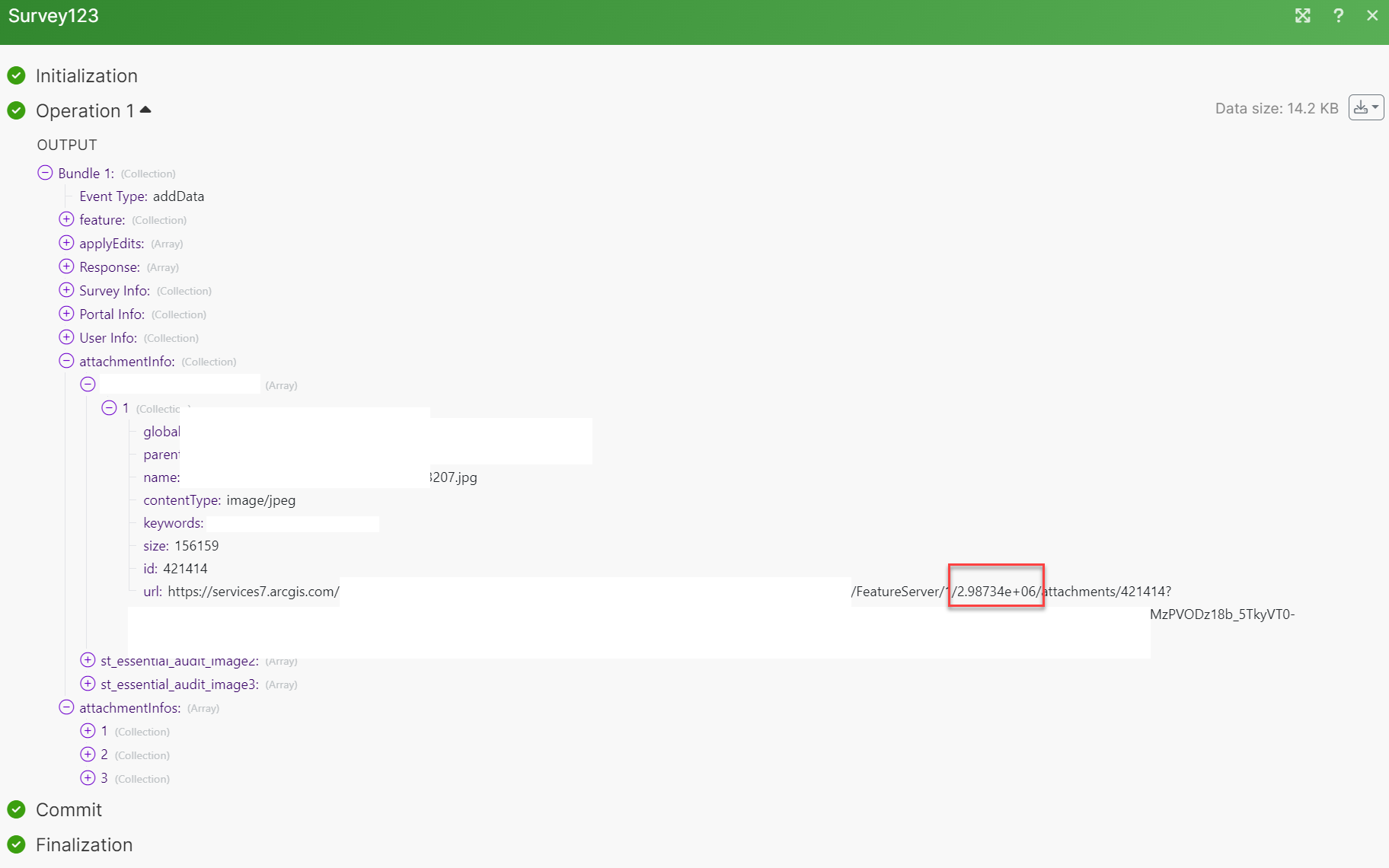

We've noticed that Survey123 webhook payloads are coming into MAKE (Integromat) with notated objectids in the URLs. It doesn't happen for every survey but is causing issues when said URL is attempted to be used in HTTP request modules.
Is anyone else seeing this or can shed some light as to why this behaviour has started occurring?
@ZacharySutherby
2.98862e+06 should be
2988616

@ChristopherCounsell @abureaux
We have logged this issue as a bug and our Survey123 team is aware of the issue. Here is the Bug number, and we will wait for it to be addressed: BUG-000171796.

I think this may be "normal behaviour" for JSON when working with large numbers. Make doesn't seem to be "decompressing" the shortened number properly. Not sure if that would be a Make issue, or an Esri issue. I'm currently leaning to Make, but I'm not an expert on these web requests.

But that begs the question of at what point does this conversion happen. Is your screen shot of the initial response, or part way through the flow? If it's the initial response, I guess there aren't many options beyond bugging Make/Esri to fix the request 😞

It appears this way in the raw json input make receives, and only the
object Id within the attachment url is impacted. It appears normal
elsewhere in the json. The images also get submitted fine...
