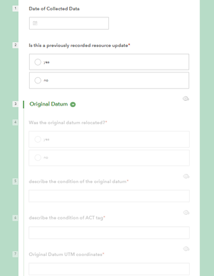

This is how I have it setup in the Web Designer: When the visibility rule is not met: Do not submit the answers in this group

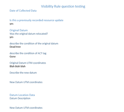

When I generate a report (using the Individual Record standard report template Esri provides), it does not appear that the visibility rule is applying to the report. Basically, I do not wish for the reports generated to show questions that were not answered because they are conditional based on the visibility rules.

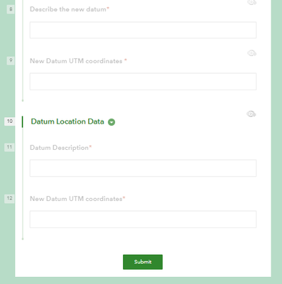

Here is how the form is setup in web designer:

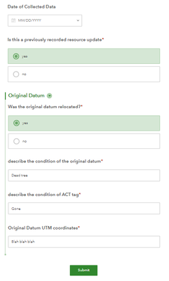

Here is how the form looks when a user is inputting data:
and here is what the Generated Report  looks like:
Is there a way to make the generated report hide questions that were not answered?
