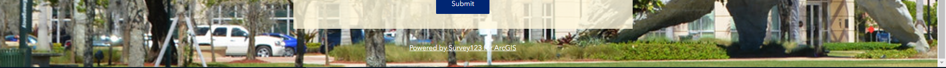

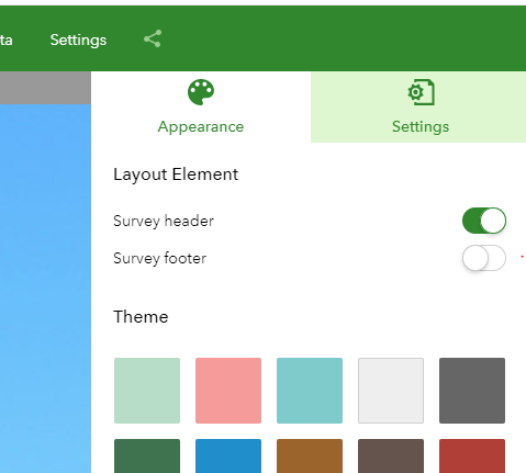

Hello,
Please see two screenshots. I have survey123 web browser (AGOL) from survey123 connect with existing secured feature service. Is there a way actually to turn off the survey header and footer? I published it and it is still display survey123 header and footer on web. Please advise. Thank you

Hi Alex,
I can see what you are describing regarding the header/footer display switches not working.  As a workaround, you can share the survey with ?hide=header,footer appended on the full survey URL (https://survey123.arcgis.com/share/<SURVEY ID>?hide=header,footer).
