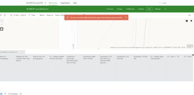

I grabbed a screenshot of the error I get.

Hi Lono,
Kindly see this thread and make sure that your survey doesn't contain name fields with reserved keywords and the query capability of the survey's feature service is enabled.
