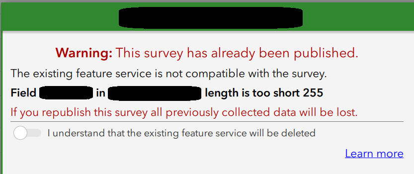

This is expected behaviour in some cases, before you published did you see a warning like this one?
JessicaWalston
Yes, but I misunderstood. I was under the impression that it was for that specific field. I still have an archived data set from the previous survey. Is there a way I can merge the previous records back to the survey?

You're right that the warning message isn't very clear. Changing field length for a single field would logically only delete data in that field, and they should definitely have a very detailed message with a GitHub style "please type the full length of the survey name to confirm" style prompt.
