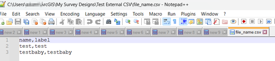

Hey community,
Hopefully a simple one here but my external choice lists are not loading in my survey123 forms. I created a simple example to test and this is the setup. What am I doing wrong?
Lee_Butler
Try placing your file_name.csv file in your surveys media folder
Lee_Butler
tiztrain
Lols so simple. This was driving me mental. Did not realise in the instructions it said to store it in the 'media' folder. Thankssssss
