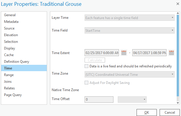

I created a survey using Survey123. In the survey, I have a Start Time filed that uses the 'start' field type. I then pull the layer into ArcGIS Pro for analysis. I noticed the time slider is enabled. I right click on the properties of the layer and go to the time tab to disable it. However, everything is grayed out and i am not able to change any settings. Any ideas on how to disable the time?

Have you tried disabling time in the item details page of the feature service?
Configure time settings—ArcGIS Online Help | ArcGIS
