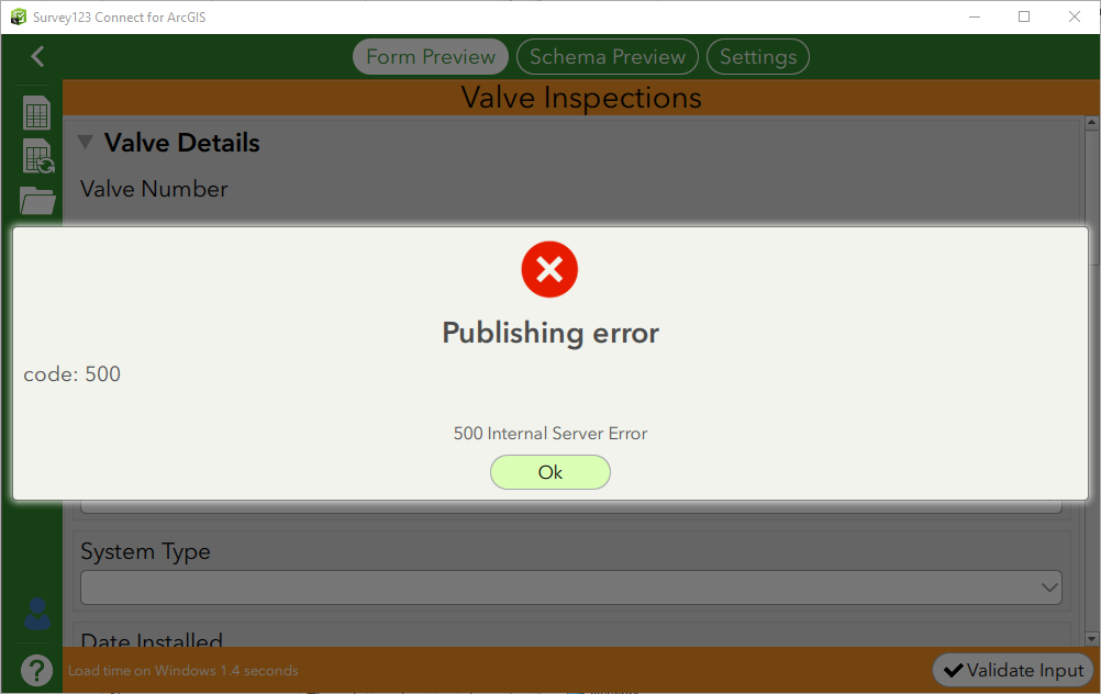

Hi,
I'm trying to publish a survey from Survey123 Connect to our internal Portal site.  When I use the publish button I get the attached error:
When I look in look in Portal the Survey folder is created, as is the feature service for the survey.  The form item is not created.
Any suggested would be appreciated.
Thanks,
Keith

Hi Keith,
i  had the same error last week.
I would suggest that you look in the admin directory of your server manager and look what protocol setting is enabled under /admin/security/config.  Enable http and https protocol support.This did the trick for me at least.
I hope this helps.

KeithHupperts
Leonhard, Thanks for pointing us in the right direction.  Adding both http and https allowed us to publish our surveys.
