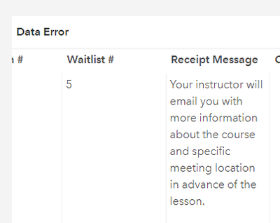

Our organization is also experiencing this issue with one of our S123 data pages in V3.12 (published from Connect).
After coming across this post we tried clearing our Chrome cache and even tested in incognito with no luck.

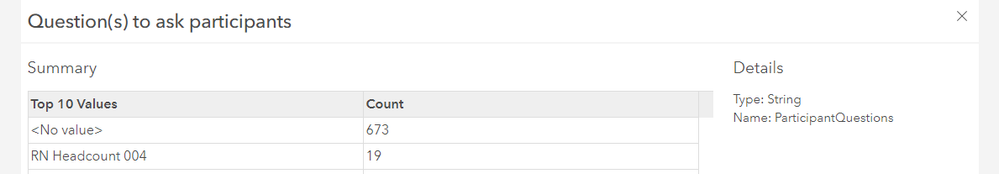

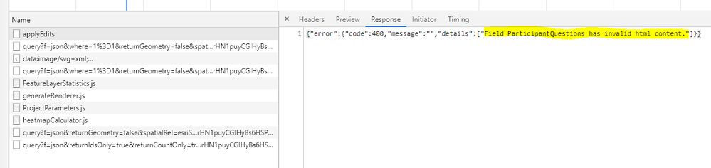

Upon further digging, I investigated the backend JSON and found that this error was being flagged by some "invalid HTML content". Seems strange right?

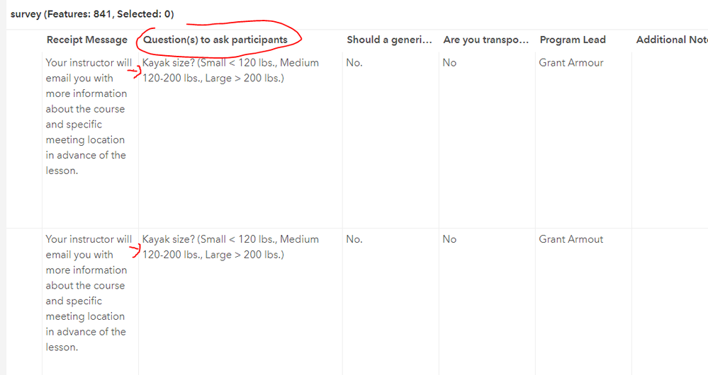

Well upon looking at the two records giving us this error it appears the > and < symbols in a String field were the entire reason why this whole thing wasn't working.
Simply > and < characters broke the whole thing. As far as I've been able to tell these are not 'illegal characters' in the ArcGIS Online data world and should not be throwing this error.

Here's the string of text for testing:
Kayak size? (Small < 120 lbs., Medium 120-200 lbs., Large > 200 lbs.)
