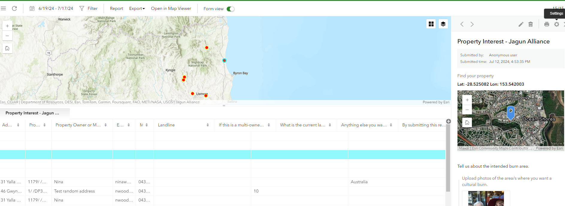

I have created a public survey on Survey123 Connect. Records were successfully submitting, however I have 1) recently updated the survey questions and 2) then followed the process to secure my data in my public survey following the instructions in this blog post here.
https://community.esri.com/t5/arcgis-survey123-blog/securing-data-in-public-surveys-survey123-connec...
After going through this process and creating a feature layer hosted results view and a feature layer hosted configured submission view, newly submitted records are no longer visible in the data tab of Survey123 website. A geolocation and image attachments come up for the record, but nothing else. I am logging in as the owner of the survey and all associated layers. See the screenshot below of the data tab view in Survey123 website.
