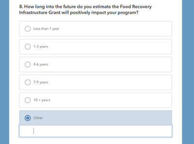

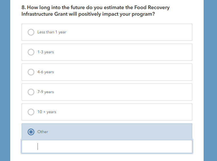

I am building a simple survey using Connect and a select_one is partially overlapping a relevant question directly below it on the survey when viewed in the browser. Is there a work around for this or is this a bug?
And no, I am not switching to Chrome because my entire agency uses Edge.
Here is the syntax for both questions in xlsx:
typenamelabelrelevant
select_one yearsfuture8. How long into the future do you estimate the Food Recovery Infrastructure Grant will positively impact your program?
textother_futureIf other, please elaborate.selected(${future},'Other')

Here is the result in the browser when "Other" is selected. It obscures the text "If other, please elaborate.":

I loaded it into my environment and saw the same behaviour. This is definitely a bug. I would bring up with Esri support so they can fix it.

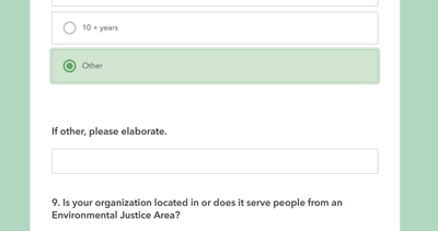

As for a short-term solution, you can add a note with an empty tag:
There is a little more space than normal between the select_multiple question and the "If other..." question, but it looks better than the alternative I think.
