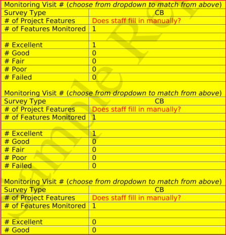

I've tried using:
${#rptFeature}${if SurveyType=="CB"}
Survey Type
CB
# of Features Monitored
${rptFeature | where:"SurveyType='CB'" | stats: "count,objectid"}
# Excellent
${rptFeature | where:"SurveyType='CB' and FeatRating='excellent'" | stats: "count,objectid"}
etc......
etc........
# Failed
${rptFeature | where:"SurveyType='CB' and FeatRating='fail'" | stats: "count,objectid"}${/}${/}
also tried ending with ${/}${/rptFeatures}
but end up with a table being repeated for each of the selected survey type records

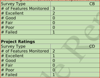

If I remove ${#rptFeature}${if...}....${/}${/} and use the following syntax, I get the correct totals for each survey type.
Survey Type
CB
# Excellent
etc....
etc....
# Failed

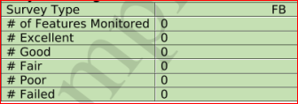

However, if the survey type does not exist (i.e., FB), the table for that non-existent survey type still persists in the report.
I cannot seem to get the syntax right for creating a table that tallies the total ratings for each existing survey type from the nested repeat. Any suggestions?
