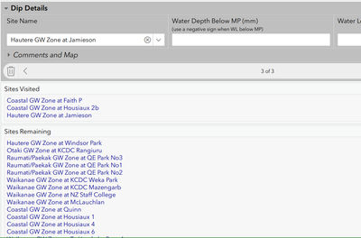

We have staff taking manual groundwater levels around a list of sites, I wanted to either have the select one list only contain the sites that hadn't yet been visited, but as this doesn't seem possible yet, I went about it a different way. I now have a text field that contains the remaining sites to be visited.
In the snip below I have a "join" field called Sites Visited that has all the sites from the repeat, separated by a line feed. The Sites Remaining field is generated using some JS that a machine wrote for me. As I complete each repeat, the Sites Visited field updates with the site name, and the site name is removed from the Sites Remaining field. You could always hide the Sites Visited field if you don't need both.

The text fields need to be larger than the default to handle all the site names, so make your bind::esri:fieldLength bigger.
Hope this is of use to someone. Critical files are attached.
