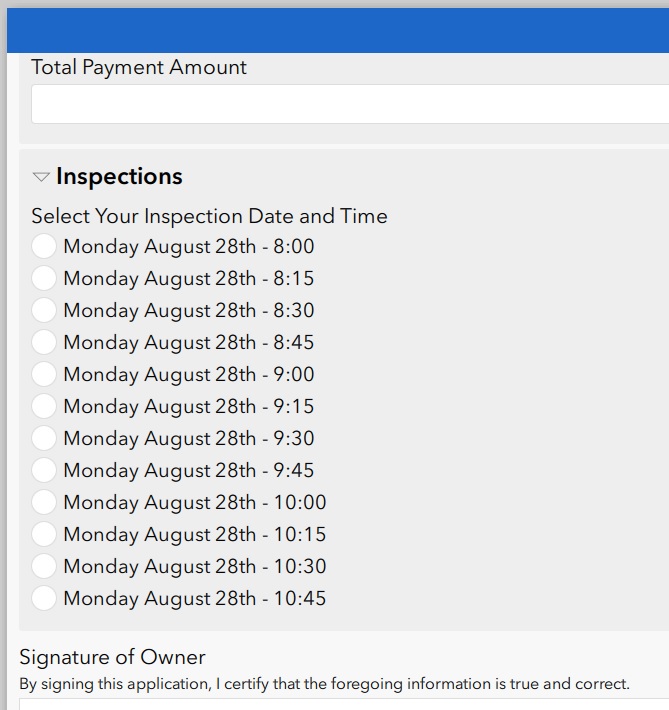

Hello, I am trying to accomplish the following using AGOL. Please let me know if anyone has any advice.
We have a public form for residents to schedule inspections conducted by our municipality. We want public users to be able to self schedule.
Workflow:
   Person A: Opens public form, selects Monday August 28th at 8:00 AM, Submits form
   Person B: Opens public form, (Cannot Select same day as person A), Selects available date, Submits form.
