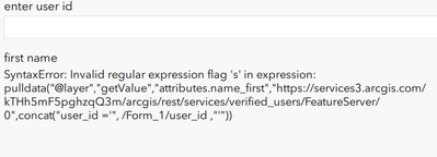

Thank you Rylee. I'm getting syntax error with the added added single quotation mark. I'm very much in the learning phase with connect, so this is much appreciated.
rwrenner_esri
Esri Alum
In the error message, I see "/Form_1/" in the latter part of the concat statement. Does that match what's in the XLSForm calculation column? I didn't see that text included your initial pulldata so wondering if it got added and if that's causing the syntax error.
RoscoPeters17
The calculations column does not have the "Form_1" but it shows up in the error. The survey is titled Form 1

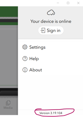

Thanks for clarifying. I'd suggest updating to the latest version of S123 Connect (3.19) if you don't already have it.
To check what version of S123 Connect are you on, click on your profile at top right:
RoscoPeters17
I was running 3.12. Just updated to 3.19 and ran the survey with the additional recommended single quotation mark and voila!!! Can't thank you enough, I would have never thought to check software version.
