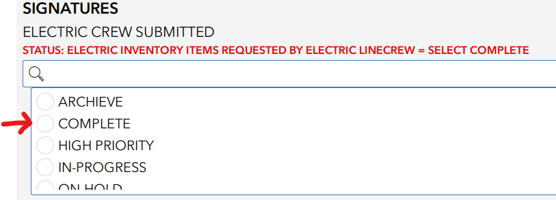

I want to be able to send an e-mail (know how to do that), when a specific attribute is selected in a Survey123 form.

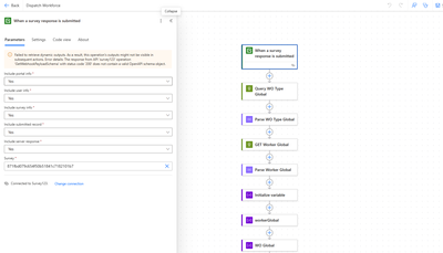

In the Survey123 survey settings, you will need to construct your webhook to trigger based on what you are needing. I would likely add two separate webhooks: one for when a survey is submitted (your initial survey) and another for when surveys are updated (when they get completed).
When the flow is triggered, so long as the webhook in Survey123 is configured to do so, all of the data from the survey will be set in the webhook and the various fields and data can be accessed as variables by other actions after the flow is triggered.
Here is an example of one of my WebHooks in Survey123 settings:

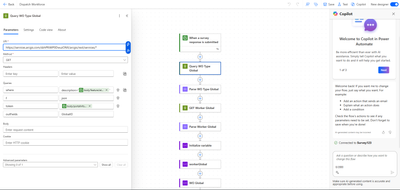

Here is that webhook action set as the trigger for my flow:
And a subsequent example of the data from that webhook trigger being passed as variables to an action:

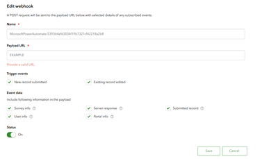

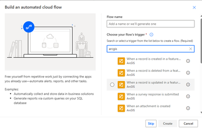

@ModernElectric  You dont want the trigger "When a record is updated in a feature layer" , you want
this will attach a web hook to your form and then you turn it on for both new and edited submissions in the web hook settings on the survey123 website page of the form ,  you then need to use a router or flow control to direct it what to do   based on the event type info in the payload of the form eg
Event Type:editData

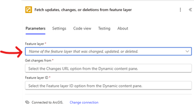

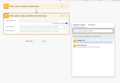

Here is the biggest frustration I am having. When a new entry into a Survey123 Form is created, the data is saved into a Feature Layer on my AGOL in My Content. On all of these triggers/actions when I try to select/choose that particular Feature Layer in the drop-down, it is not visible. How is there an additional method to select that Feature Layer created from the Survey to run a query against?

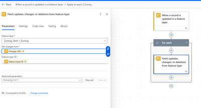

The 'fetch udpates...' action seems to not be meant to be used independently -- it should be used as an action within an automated cloud flow that starts with the 'When a record is updated in a feature layer' automated trigger.
It may seem redundant to specify you're 'monitoring' a specific layer via the automated trigger, but then you specify again that you are fetching the updates from that layer.

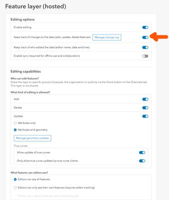

All that said... I just tested this one a junk layer in my AGOL site, and the automated webhook doesn't seem to be triggering when I add/update/delete a feature in the layer I specified. I saw in the 'flow checker' that it indicates I needed to enable change tracking. So I did, and then edited the automated trigger, and it seemed happy, but I'm still not getting any triggers after editing features. I also confirmed the AGOL feature service has the webhook enabled.

That is not the issue. I am the only owner/administrator/developer/creator. The problem is all of the Survey123 forms that create a Hosted Feature Layer in AGOL when I construct a new form, are not available in the drop-down in the Power Automate :
What I want to be able to figure out is when a Survey123 form is started, and an unique attribute is chosen, it triggers a notification but not create a report until later stages. However, without the ability the choose the Feature Layer to build a query against a given field I cannot proceed.

@ModernElectric have you change tracking enabled on the layer in question? Either way you can try use the url to the feature layer and insert it using a custom expression .
