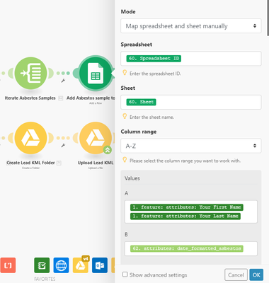

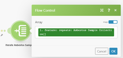

Sorry I don't have a screenshot to show you how it would be configured in Integromat. I do the opposite with an iterator, so that I can add each record as a row to a spreadsheet (which would cause an email to go out for each record, which is what you're seeing). On the off chance it helps to, here's a screenshot of how my iterator is set up by pointing at the repeat table:

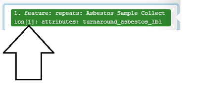

If you're after the latter....you can ignore the first part of my post since you won't need to aggregate all those records into one.   You would need to find the max() index of the record in your repeat and then set up MS flow to only email the record for that index position.  I'm not sure how this looks in MS Flow, but in Integromat you could insert that index position here:
