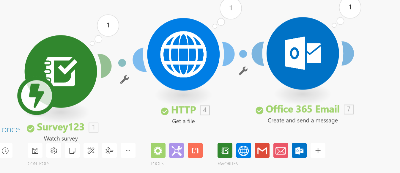

Shwu-jingJeng
Hi Rachel,
Could you try to modify the integromat webhook to use the Office 365 Email as a connector instead of the gmail connector in your webhook?
Using this workflow can narrow down if it's the Outlook client issue or the webhook issue we need to further check.
My initial testing here using the Office 365 Email connector in webhook does work sending the attchment.
