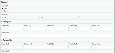

Hello Geonet users,
I am having issues using pages with theme-grid and nested groups. I have several nested groups that I cannot seem to get consistent widths. I am looking to have Group 1A, 1B and 1C each on their own full width row, not all three in one row. Within each group the first 5 fields would be a width of 1 and last being full width (5). Attached is an example xlsx form and a picture to show an example. I would appreciate any feedback I might get.

Yes you can.  I think I did it by using w1 field-list at the page level.  This basically makes the page not a grid then add your groups that are grids inside of the page group.

Like this?
I moved the last end group to line 6 so that they are not nested anymore.  Hope that works for you.

Yes, that is the layout I am looking to accomplish. Thank you for taking the time to work up the example. Though, I should have added a second page to the example, since it is just 1 of a 9 page survey. I may be mistaken, but I believe I must have a group for each page. Do you happen to know of a solution for use with a multi-page survey? Thank you for your time.

Yes, that was the solution I was looking for! Thank you Doug. I have attached an updated example using Doug's solution.
