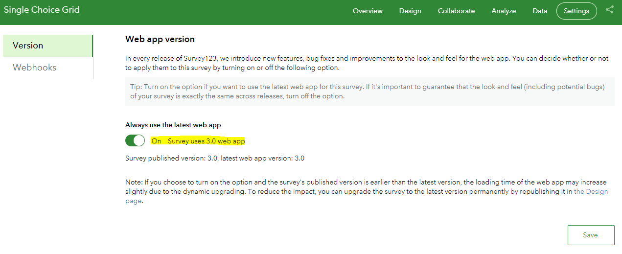

Also have you tried viewing the single choice grid in latest 3.0 update of the Survey123 web app, which was released just a few weeks ago. When I create a single choice grid question with very long questions and choices, it displays them correctly without overlaps:
If you published your survey before the 3.0 update, you may need to enable the version setting to always use the latest web app to get any recent fixes to this question type. You can find the version settings under the Settings tab:
