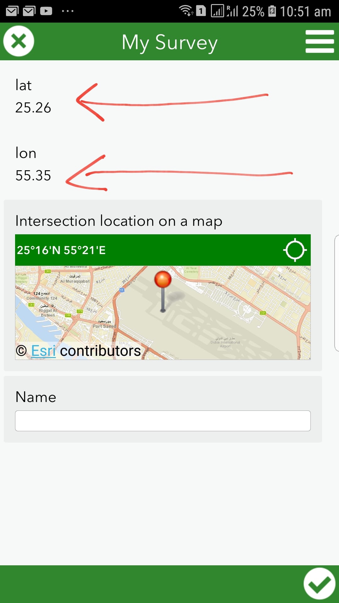

Hello All,
I have been experiencing an issue when bringing in the coordinates from Collector into Survey123. Within the feature service the data is stored correctly. When I try and display the coordinates within a note or a decimal within survey123 the coordinates are truncated within the mobile app on a mobile device compared to viewing it on the mobile app installed on the computer. Any cause for this or a work around?
I have tried storing it as a string and performing calculations with the number
Thanks!!

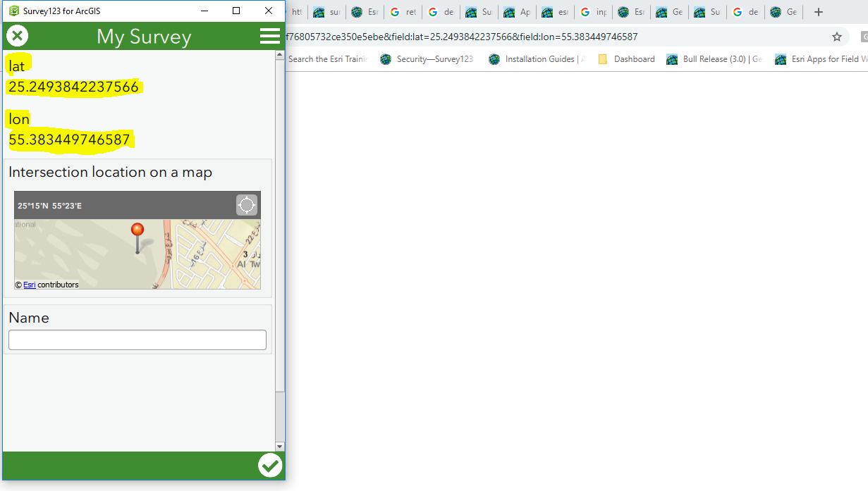

Hi Kevin,
It sounds as though the problem is with the url that Collector is creating on the device is rounded to 2 decimal places. Can you confirm in Collector for those 2 fields in the pop-up that you see all the decimals? If not this coudl be the cause of the problem. Modify the pop-up in the webmap to include all the decimals, not just rounded to 2 places.
If you look at the url in your first screenshot above on Windows, the lat and lon variables have all the decimals, so this is what is passed into Survey123 and it shows correctly. My guess is that if you could see the url on the device that Collector generates, it is rounded in the url already from Collector.
Phil.
