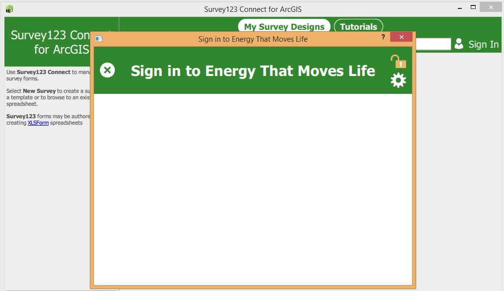

Hi everyone,
i am planning to use survey123 for collecting data in my organization, i successfully configured it for Portal for arcgis 10.4, but when i try to login the blank window appear and i cant sign in.
Can anyone help me to resolve this issue?
JayantaPoddar
MVP Alum
Check the post sign in to the portal arcgis dialog is obtain blank page in webview !!!
It could be sue to the use of a self-signed certificate for SSL instead of a CA-signed certificate.
You could contact Esri Tech Support.
