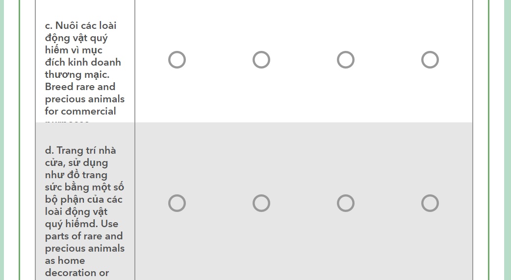

I am having trouble with language display on browser for questions with tablist appearance. The survey is in Vietnamese and English, and I set the default language to Vietnamese. There is no problem when opened in Survey123 app, but in browser, all tablist questions appeared in both languages as in the photo below:
This only happen to tablist questions, all other questions are displayed in Vietnamese normally.
Can someone please tell me what is the problem?

Hi Ha Anh Nguyen‌. Thanks for bringing this up. I was able to reproduce this problem using the attached XLSForm. It looks like a BUG in the software that needs to be resolved.  To get this software defect properly logged I suggest you open an official Esi Technical Support case. You can reference this Geonet discussion when opening the case. Once an incident is created you will be able to track progress of the issue.

Thank you for your help. However, the issue persists even when I use your XLSForm. My only guess is that because I have multiple questions within the table-list group (instead of one question as in your form). I have attached part of my survey  below. It would be great if you can help me look at it.
Meanwhile, I will report the bug as you suggested.
Many thanks!

Thank you for the feedback. The fix to this bug will be included in the next Survey123 3.9 release (planned in April), please stay tuned with our blog.
By the way,
  • Ismael's attached XLSForm is used to reproduce the bug but not a workaround for your issue.
