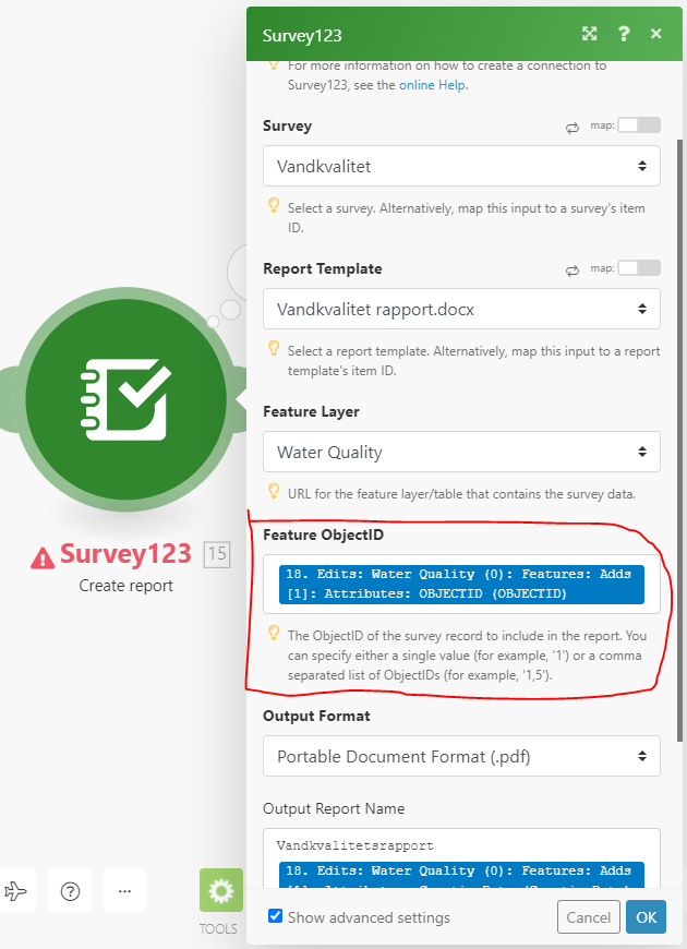

Hi,
I'm trying to combine ArcGIS Field Maps with Survey123 Feature Reports and automate the workflow through Integromat.

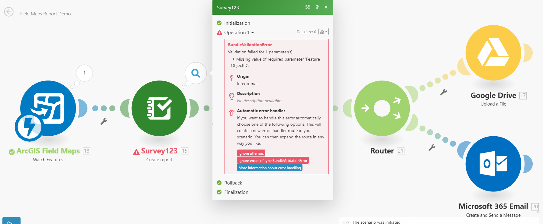

My setup has worked fine, but suddenly I recieve this error: Missing value of required parameter 'Feature ObjectID'.
I have Set up the Survey123 module to take the objectID from the feature:
Any suggestions to what might go wrong?
/Thanks
Niklas

Hi @Niklasg ,
Can you provide the details of the result of the Field Maps action (hover over/click the '1' that is on the upper right of the icon)?  One thing I'll note is that the Field Maps action is designed to return several features (indicated by the array notation in the placeholder); I'm wondering if the wrong number of edits is being referred to (I'm seeing the [1] entry being accessed; for single-feature edits, I would expect to see the [0] feature be accessed).
Niklasg
Hi James
Thanks for the help. I set up the Field Maps module again and now it seems to work everytime. However I can't seem to recall what I did differently this time.
But it works so thanks for the help.
