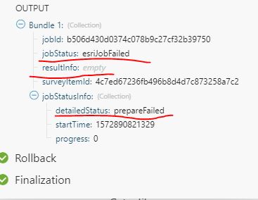

I have been using Intgromat for  awhile to automate survey123 report generation and emailing. Recently My scenarios have stopped working and I cannot seem to fix it. I am noticing that in integromat in the "Create Feature Report" module the output bundle is coming up as a failure and no information is being passed through.
Here is a screen shot of the failure message.
I have reconnected the webhooks, re uploaded the report template, recreated the integromat workflow, just about everything I can think of, the report generates manually through survey123 and I am out of ideas. I really need this fixed any help would be greatly appreciated.

Hi. By looking at the error, it seems like your template may have a syntax error. Please note that as of 3.6 the syntax validator was enhanced to catch some syntax error that before were ignored.  A side effect of this is that some reports that used to 'work' (incorrectly) in the past now will fail. See details in the Feature Reports section at: https://community.esri.com/groups/survey123/blog/2019/09/26/hobbit-day-release-36
This is just a guess based on your screenshot above. The best would be to carefully review your entire template syntax. An Esri Technical Support analyst could help with this.

I have reviewed my syntax and I cant find any issues. Further more I have set the survey back to its original release version and that did nothing. I set the survey back to the 3.6 release, created a "example" template through survey123 and again this does not work. I am unsure what exactly has been changed in the syntax is there any better documentation other that the Hobbit day release article?

I had the same issue too and found that it is more of a Survey123 version problem.
Try setting the survey to use the most recent version, something like this, and I got that resolved after I did that.
