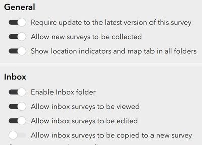

We have the Inbox enabled on our Survey123 forms, but when viewed through the Inbox, the repeats show empty / blank. The forms were all built in Survey123 Connect, and have been tested on desktop and mobile devices.
Inbox enabled in ConnectInbox enabled in Connect

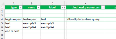

@ShelbyZelonisRoberson
Please try including both the query and allowUpdates = true in the same field
This should resolve your issue
alext89
I was having the same issue as the OP and this solved it for me.  Thank you!
