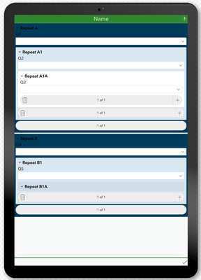

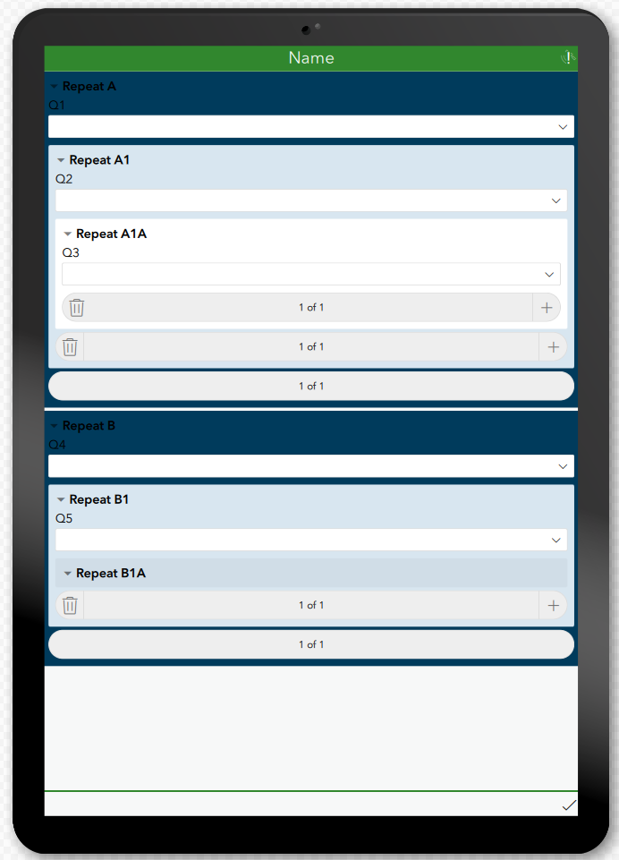

Hello all, I hopefully have a simple one. My S123 form aims to help users populate information for asset inspections. For some assets, they may have repeatable sections that have the same information between sections, hence I'd like to minimise how much data entry occurs on site.
In my S123 xlsx, I am attempting to populate a second repeat based on the answers of a previous repeat. My logic in the calculation field for the second repeat (for Q6) is:

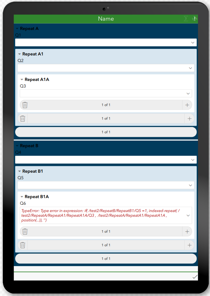

if(${Q5}=1, indexed-repeat(${Q3}, ${RepeatA1A}, position(..)), '')

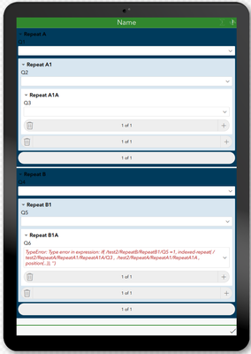

The aim here is to populate Q5 with 1 or 0 (Yes/No) based on if this asset's particular section has the same information as the other section. However, this calculation throws a "TypeError" in Q6:
I have looked at other help questions with similar issues and have changed the esriFieldType but can't pinpoint the esriFieldType I need. I have also changed Q6 to "calculate" instead of "select_one material" but this just makes Q6 not appear correctly:

DeonLengton
split your calc in two for the retrieval of the selected material in the first repeat
see attached Excel file... hope it helps

DougBrowning
MVP Esteemed Contributor
Q5 is a string have you tried quotes on the 1?
if(${Q5}= "1", indexed-repeat(${Q3}, ${RepeatA1A}, position(..)), '')
Also it looks like you want to check in the same repeat number?  If so no need to index it at all.
Just  if(${Q5}= "1", ${Q3}, '')  would work.
Try that.

DeonLengton
JeetzPatel
Thanks Deon, this worked pretty well. The need for another field is tough but I can work with that.
