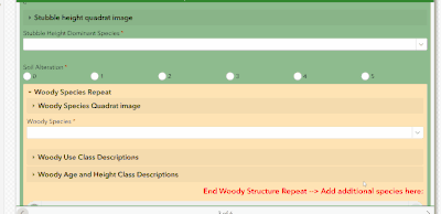

Agree with above a group seems to work best.  We use this for diagrams.
