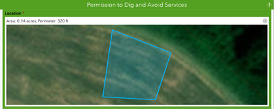

I am currently trying to edit my geoshape question so that once collected, the view (current view below) has a greater extent (is not as tightly zoomed in), is there a way to achieve this?

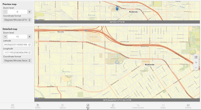

If you authored your survey in Connect on the Map tab you can set the extent of the Preview map to be zoomed out.

That doesn't seem to change the viewing extent, eventually that view will be part of a feature report and I would like the extracted image to provide a view of a greater extent for context in the report.
