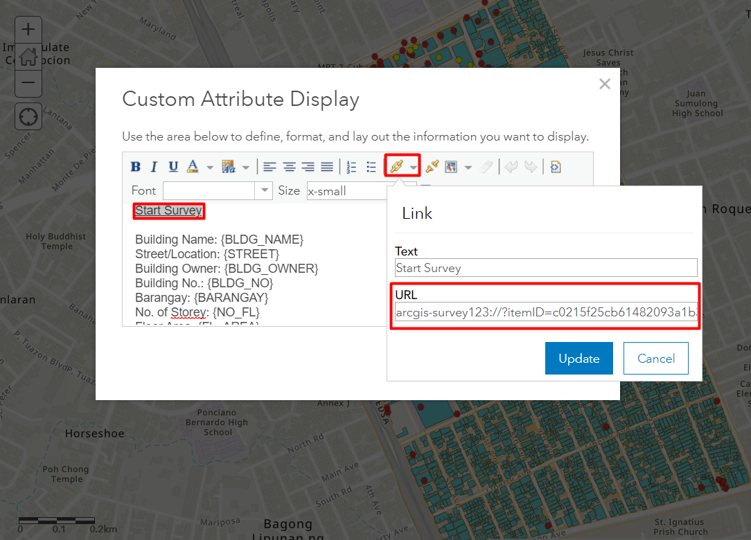

The said form will be launched using a “Start Survey” customized URL link embedded in a web map that we have also prepared. (Please see the screenshot below)

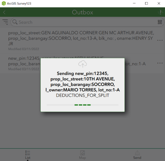

When we clicked the “Start Survey” link in the Web Map, the form launched successfully. However, when we tried to submit the filled-out form, it got stuck on the sending screen. It does not send but it also has no error displayed. (Please see the screenshot below)

We have done additional testing regarding this issue. We used 3 different forms to test (Machinery Form, Building Form and Land Form) which consume feature layers that are also not hosted (same setup above). For Land Form (with records that are 1:1), it works perfectly fine. However, for Machinery and Building Forms (with repeat groups inside), sending got stuck with no error displayed.
For Building Form, we further conducted a test and removed the repeat groups. It surprisingly worked and successfully sent. However, for the Machinery Form, it didn't work even after removing the repeat groups.
Attached below is the Building Form. Should you have any other hints and ideas on how to address this issue, we would appreciate it very much.
