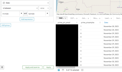

As my post states, when pulling a feature report using the date filter parameter, the feature reporter does not pull data collected on the final day of the month. This is the second time this has occurred, so it is a repeating issue. Please see the screenshots below as examples. One important note is I am not using the default creation date field, rather a dateTime type field on Survey123 Connect with the Default value as now()
Does anyone have any advice for me? Could this be a time zone issue, as I am on EST time?

I see the same behaviour in my database (e.g., November 30 only appears when I expand the range to December 1):
This is not an issue with the query though. I really hate simplified queries, because it's hard to tell if it is >= or just >. In this case, it IS >= as I see November 1 when I search for November 1. This leads me to believe that some weird UTC stuff may be going on here, so we don't see what we should be seeing.
