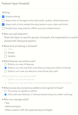

I get the sense from many troubleshooting searches that it could have to do with the sharing and editing configuration. Here is the editing configuration for the feature layer:

Hello @gmcgwn
What you are seeing is likely due to query being disabled on the feature service. If you switch "What features can editors see?" to "Editors can see all features" that should enable query on the feature service. Do you still see the same behavior?
