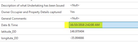

I then bring in this feature layer into a new ArcGIS Pro Map, then open the attributes table, and the same column is displaying UTC time:
Can someone tell me which format the time is actually stored? I am guessing the data is stored at UTC and the survey website applies a conversion to display local? Can this be confirmed?
Also how do I apply this same conversion so ArcGIS Pro displays my data in local time, as in my organisation we 100% of the time work in local time, never in UTC.
Any suggestions?

Hi Ben,
You are correct - the data in ArcGIS Online is stored in UTC time; the web apps automatically compensate, however in Pro the compensation is not automatic.  See Set the time properties on data—ArcGIS Pro | ArcGIS Desktop  and Convert Time Zone—Data Management toolbox | ArcGIS Desktop for more information on compensation in Pro.
