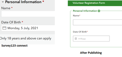

Hi,
Is it possible to change the date format in Survey123 . Now, it is showing as mm/dd/yyyy and I want to change as dd/mm/yyyy.
Please suggest
Thanks,
Saniul

sanio
Hi Thomas,
Thanks for reaching out I Have added the codes in calculation it works fine in connect, but after i publish the form the format doesn't work please go through the attach file.

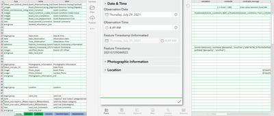

ThomasHamill
Hi @sanio, I have a template in which I use the date format calculation to produce a timestamp that I can use as an ID.
When the date is auto-populated, it still shows up in the live form as something like "Thursday, July 29, 2021," but when the observation is submitted, another field records  the full and reformatted dateTime as "20210729044923."  You can see this in my screenshot under the read-only "Feature Timestamp" field.
Apologies, I'm not exactly sure how to adjust the appearance of the date in the form view unless you do something like I did by printing a read only field just below with the dateTime reformatted as you want it to appear.
Kindest Regards,
t
