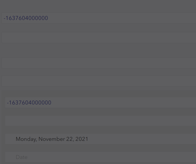

I don't think I've yet mentioned it in this thread, but I have also tried starting a completely fresh form using the existing hosted feature service as the starting template.  That works fine - the form renders in Connect without any problems - but the feature service alone doesn't quite match form configuration I need for this project.
As soon as I clear all the rows (on both the 'survey' and 'choices' pages) and then copy my original form's rows and paste them into the new form - making sure to paste-as-values - as soon as I save the excel form to refresh Connect, that's when the freezing/locking behavior starts.
I've noticed that sometimes Connect does seem to render part of the form before freezing:
Based on this snippet (I can't scroll down in the frozen app) it seems like maybe the field types, defaults, and calculate functions are rendering properly, and something is hanging when it gets to loading the field labels since they're still blank in the image above?  It's hard for me to say, since I don't really know how Connect's form rendering processes work.
Absent any other specific tips, it looks like I don't have any choice but to try a true line-by-line rebuild of the form, no copy+pasting from the original.
