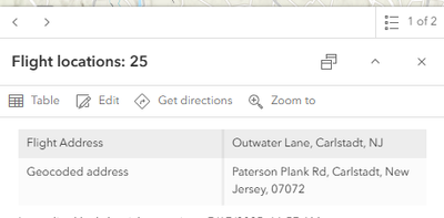

So I did the hidden geopoint question and it just puts a second point at my location (because my location services are on like you later asked). At least I'm closer than null island now, but still wish it was only one point with all of the details, or if someone submitted multiple points each point would show up with the same form information. Right now when I select the point at the actual location it just displays this with no other information. (the 2nd page in 1 of 2 is for a different layer).
Neal_t_k

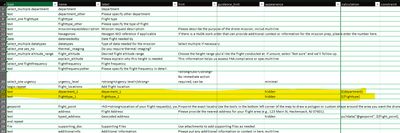

That is all you are asking for in the repeat section.  If you want to pull in data from the main section you will have to either calculate fields from the main section or asks those questions in the repeat section.  If all the questions in your main section only need to be asked once that is the correct place for them, but it sounds like you actually don't need a geopoint in the main section and just want to use the repeat section as your "main" data sheet.  If that's the case just make a bunch of hidden fields to capture all the data you want from the main form inside the repeat.
Do this for all the fields you want to see with a point.

I think this is what I'm going to end up doing. Thank you...I wish it was simpler haha, but it is what it is I guess.
