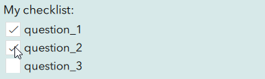

In the Excel:
In the app:
JS function:

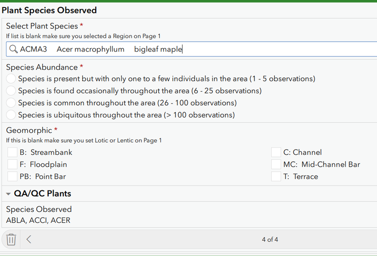

What I do is have a rolling summary at the bottom using a join().  I also have summary pages at the end.
Like here under the QA/QC group I have a running list of all species added so far.

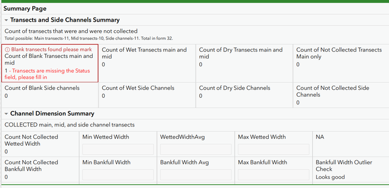

Here is a Summary page with totals, avgs, min, max, etc and even Red warnings when things are off.  It uses a grid to make is compact and easy to read.
I think this would be enough for the users and be way easier and more stable.
