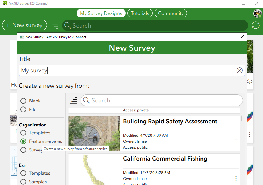

From what you describe, I suspect that your survey is not really using your ArcGIS Pro layer.
In short:
  • If you created your survey using the Survey123 web designer, then your survey is definitively not using your ArcGIS Pro layer.  All surveys created in the web designer use layers that Survey123 creates when you publish the survey (in your hosted data store).  You can definitively bring your survey layer into ArcGIS Pro, but you cannot create a survey from an existing layer you created in Pro.
  • If you created your survey using Survey123 Connect, there is a chance that your survey is using your ArcGIS Pro layer, but only if you followed very specific steps.  Typically, when you create a new survey in Survey123 Connect, a new layer will be created for your survey. However, it is possible to choose the option to create a survey from an existing Feature Service, as shown in the image below. I am not sure if you chose that option originally. When you create a survey from an existing layer, that layer could come from either your hosted data store or from a multi-user geodatabase.
  • It is also possible to manually edit the submission_url setting in your form to have a survey target an existing layer.

IsmaelChivite
Esri Notable Contributor
In short:
