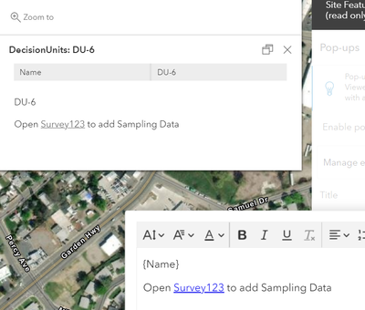

I have another easy win for you guys. Now that I've added in the link as text in the pop-up, I notice only the link is appearing in Field Map mobile. All the other fields in the pop-up have disappeared... And then, when I remove the text (which contains the link) in Field Map web/desktop, all the fields appear again in the mobile version. Field Maps on web/desktop looks perfectly normal, but it's bugging out on mobile. Both are online. Haven't moved over to offline yet. Yes, I'm saving in Map Viewer. I'll try starting from scratch and creating a new map/adding the layers, but if you know of another solution, I'd be keen to hear.
SolanaFoo2
Regular Contributor
That's great, you figured out the text option!  I noticed the same behavior as you too.  One way to access the rest of the fields is to add the field to the text input by using curly braces:

@ArielRetuta It is in the pop up settings, you will add a Text content.
