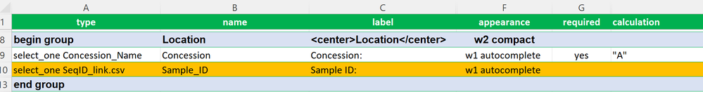

Good day, ESRI Community
We have various concessions e.g.: A,B,C etc...
Each of these concessions have a set of sequence numbers starting at number 1.
The sequence number is based on the number of samples taken.
We would like a formula that looks at the existing feature service.
Firstly the concession name, and then the last sequence number of the concession, and then add 1 to the last sequence number.
Currently its a select from an external csv, which is incorrect.
DougBrowning
MVP Esteemed Contributor
You can use count() or position() but neither are perfect.  If they go back in a repeat and delete a value it gets all messed up.
Have you seen this post  https://community.esri.com/t5/arcgis-survey123-blog/creating-ticket-numbers-in-survey123-for-arcgis/...
