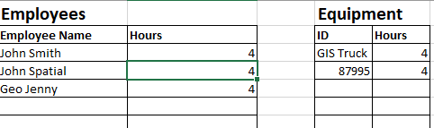

Data is currently collected in a paper form then migrated into an excel sheet like below.
Staff would like to use Survey123 to track their work and the number of hours each available employee was on-site and equipment used.
Any ideas on how to design this workflow?

Hi Antonio,
Have you considered using a repeat in your survey, one for time and one for equipment, you could have the parent layer having the persons name, and then in each repeat you enter the details. Would this work?
