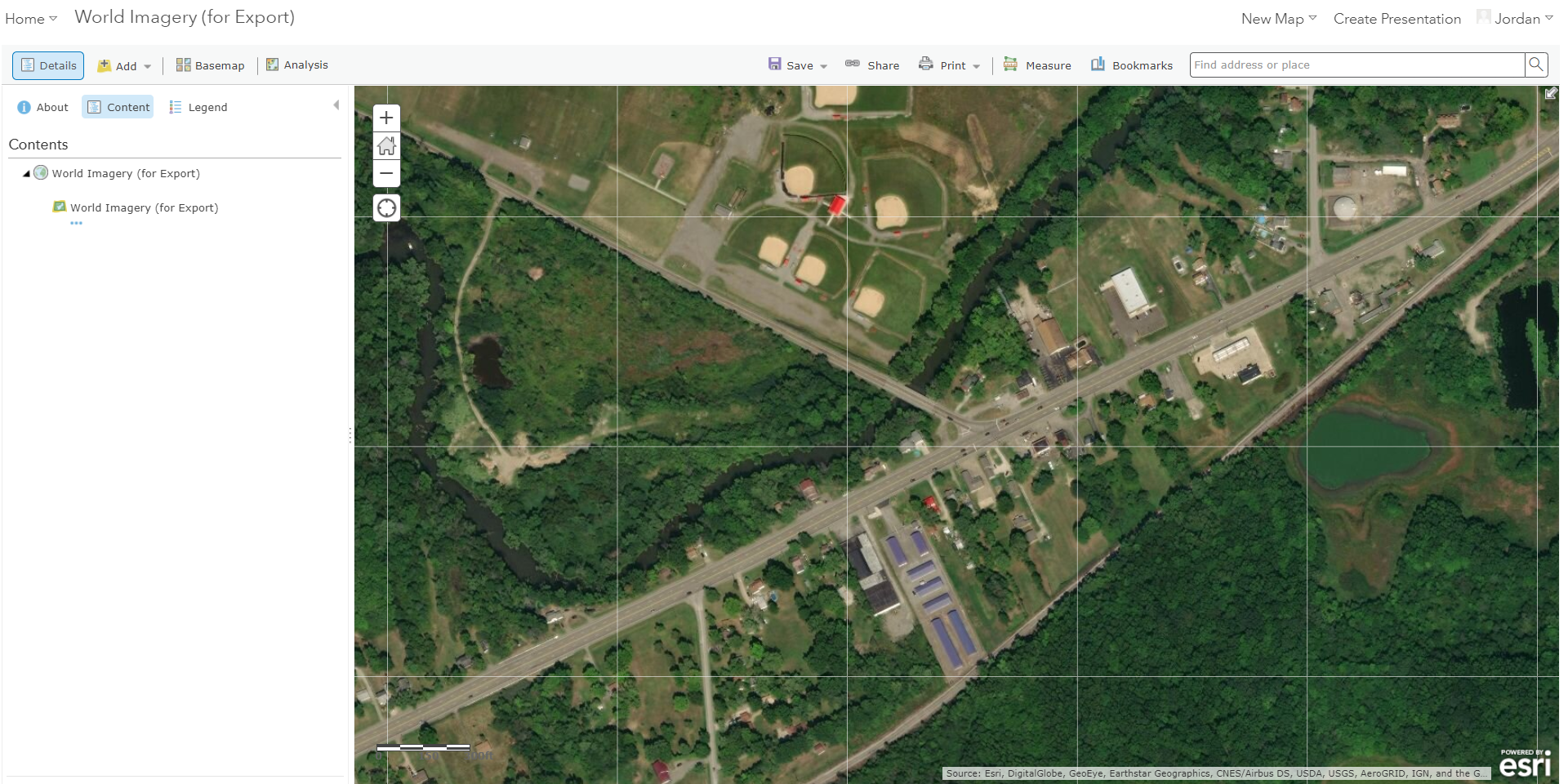

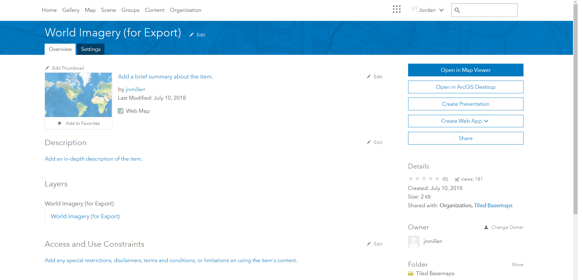

I'm trying to add our "World Imagery (for export)"  from portal to survey123 but I can't get it to show. Maybe I set this JSON script up wrong? Does anyone have an example where you've got something to display from Portal? When I run the script in the JSON Formatter & Validator no errors are generated.

Hi Jordan,
Survey123 supports services only, not web maps.  Click on the entry in 'Layers' and get the service URL - that will be what Survey123 expects.  See the example in Include a map in your survey—Survey123 for ArcGIS | ArcGIS
