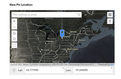

  • geopoint. This will use a calculate to center the point on the map, thus giving your surveys location data!
Here is what is looks like in Connect:

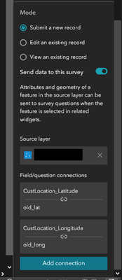

EDIT. Forgot to include what the other half looks like in Experience Builder:
Two notes:
  • You may need to set default=null for the geopoint for it to work.
  • Doesn't matter in your case since the geopoint will be hidden, but the S123 geopoint doesn't like to zoom in. E.g.:
