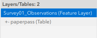

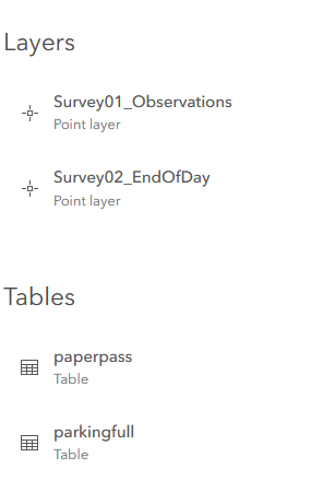

I'm trying to create a survey in Connect from an existing hosted feature service in AGOL. The service contains 2 point feature classes, and related tables. When I create a new survey from the service, it only brings in the first layer in the service and its related table. How do I bring in both layers to this survey, or at least create a separate survey using the second layer?
I see where this post specifies the first layer in a feature service. Can you only create a survey from the first layer in a feature service? https://community.esri.com/t5/arcgis-survey123-blog/working-with-existing-feature-services-in-arcgis...

You can create a survey from any layer in the service, but if it isn't the first one, it can be pretty tedious.
On the settings sheet of the excel wookbook, set the form_id to match the name of the layer in your service, and your survey will apply any edits to that endpoint.
The tedious part is that it won't pull in any of the fields, domains, field types, etc., so you have to build your worksheet from scratch.
