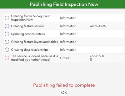

AnupNair
Hello,
We are also facing the same issue. Have you found any solution for this?
 Thanks in advance
