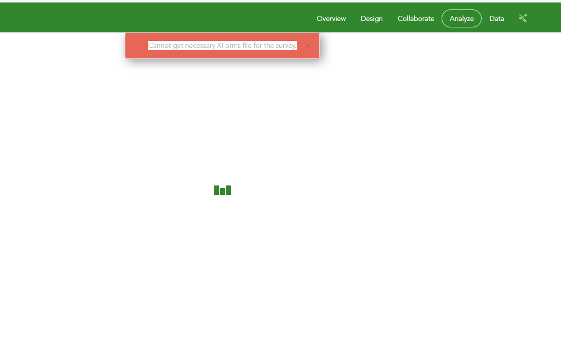

MaikGrabow
Deactivated User

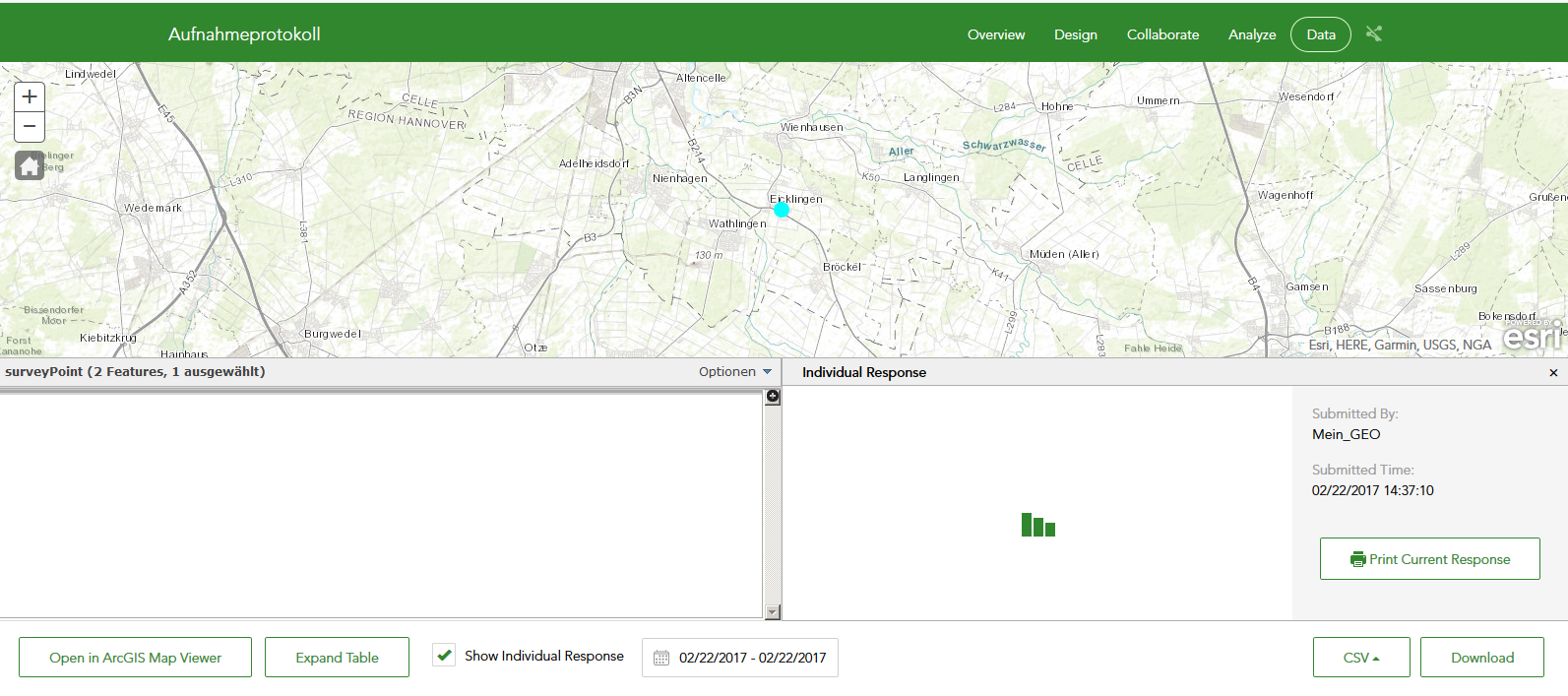

I've got a little problem with survey123 web. I completed succesfull the form, but after putting data in it I can't open it (In Individual Response it's loading, but nothing happens). After completing the survey I clicked on Analyze but a red sign
shows me "Cannot get necessary XForms file for the survey." Does I need any Excel File to use Survey web, I thought It's a "standalone"? Can anybody help me?
