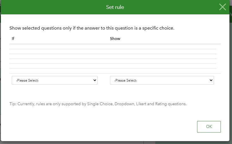

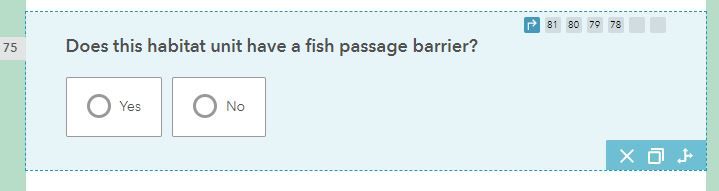

@Anonymous User,Set rule page is blank and does not allow for further editingSet rule page is blank and does not allow for further editingQuestion has missing rulesQuestion has missing rules
I too am having the same issue. After each edit to the rules, I save then preview, and when I return to the Design page, a lot of the rules are missing or randomly pointing to other questions that are not related. When I try to edit the rules, the "set rules" page is completely blank.
