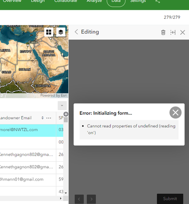

See screen shot below that is appearing intermittently across our forms emebedded in  dashboards
the same dashboards were working fine a few days ago and no changes have been made to either the form or dashboard. it only occurs when the form is opened in edit mode. the globalid is present in the feature layer also .

I implemented the change, wrapping note and read-only text fields with the html, but now I'm getting a different error through the Survey123 page (Screen Shot). I attached the XLS form. Really need this to be fixed for field staff using the application - thanks for the attention ESRI staff. I implemented the fix  on the green highlighted rows in the xls form.
