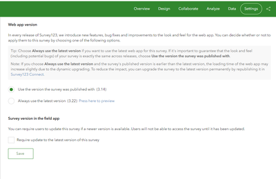

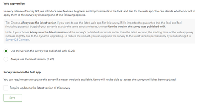

Just a hunch but open your form in the survey123 website and click settings. What happens if you set it to either one of these options?

Thank you for the suggestion. Unfortunately my options are the same either way and didn't have any effect when I used both of them.
